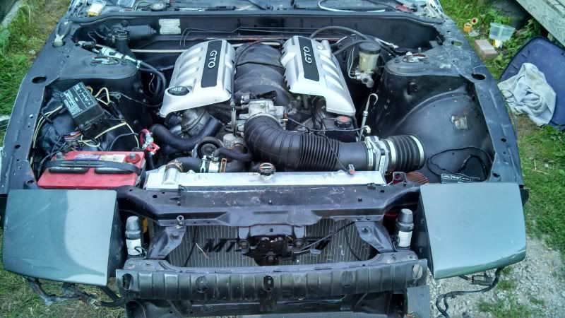

PostSubject: Re: traphiks build - ls1 / t56   Thu Aug 15, 2013 7:03 am
Well I figured it out
Wired a new relay in for the pump
Got the radiator in
Jill fired it up for the first time
Runs. And sounds healthy too
Need to tighten down the oil filter relocation line more
Slight leak
Need to do brake booster hose
Get a air filter
Put the car back on the ground
Make a shifter
Radiator fluid
And attach the throttle cable
Hoping to take out out tomorrow

Engine bay show before the wire clean up and filter was put on
