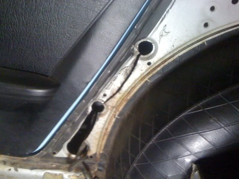

Well removed the interrior last week. Found removed the rear panel only to find out that for some reason, the inner quarter panel was cut off.... Don't. Know why. I welded in another precise of sheet metal. Took me 2hrs just to do this. Listen learned that flapper wheel will thin out metal right away.

Looks to me like someone replaced that dogleg area including the door sill and was too lazy to weld the backside. I am not sure if you are planning on painting the whole car, but it would be in your best interest to strip that whole area on the outside to bare metal first. When I had my car the bodyshop didn't seam weld the area and spotted it/filler which cracked after 5 years. Just a headsup, that area is one of the most common to rust.
Your repair looks pretty good. Not sure how many flapper wheels you will go through, but I found this place online that has amazing prices on that stuff. http://www.lehighvalleyabrasives.com/servlet/StoreFront
I plan on stocking up, the ceramic flap discs are supposed to be amazing.

Yeah I tried looking to see if they replaced anything but, everything still has the factory spot welds. Yeah the the car will be getting painted hopefully by the end of summer. Will be putting in por-15. Thanks for that link I may just have to hit that up.

Wow just check that site out. Shits cheap! Ill be buying goods from there next week, thanks for that site. Also I decided I'll be replacing the floor board with zedd findings floors. I did notice they had stereo wires for the speaker. The harness I removed that goes back there had some melted insulation. I guess they were trying to get to it and must of giving up. Deck installation gone wrong I guess.
