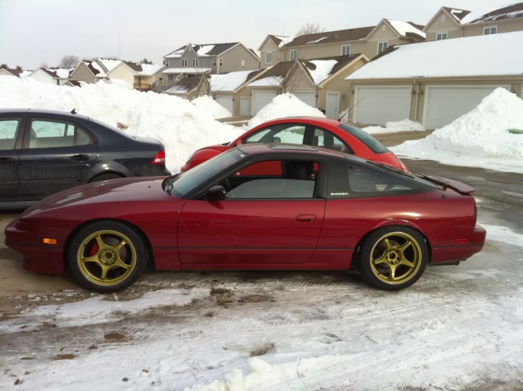

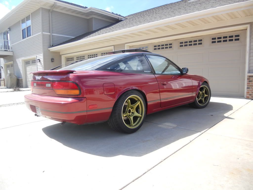

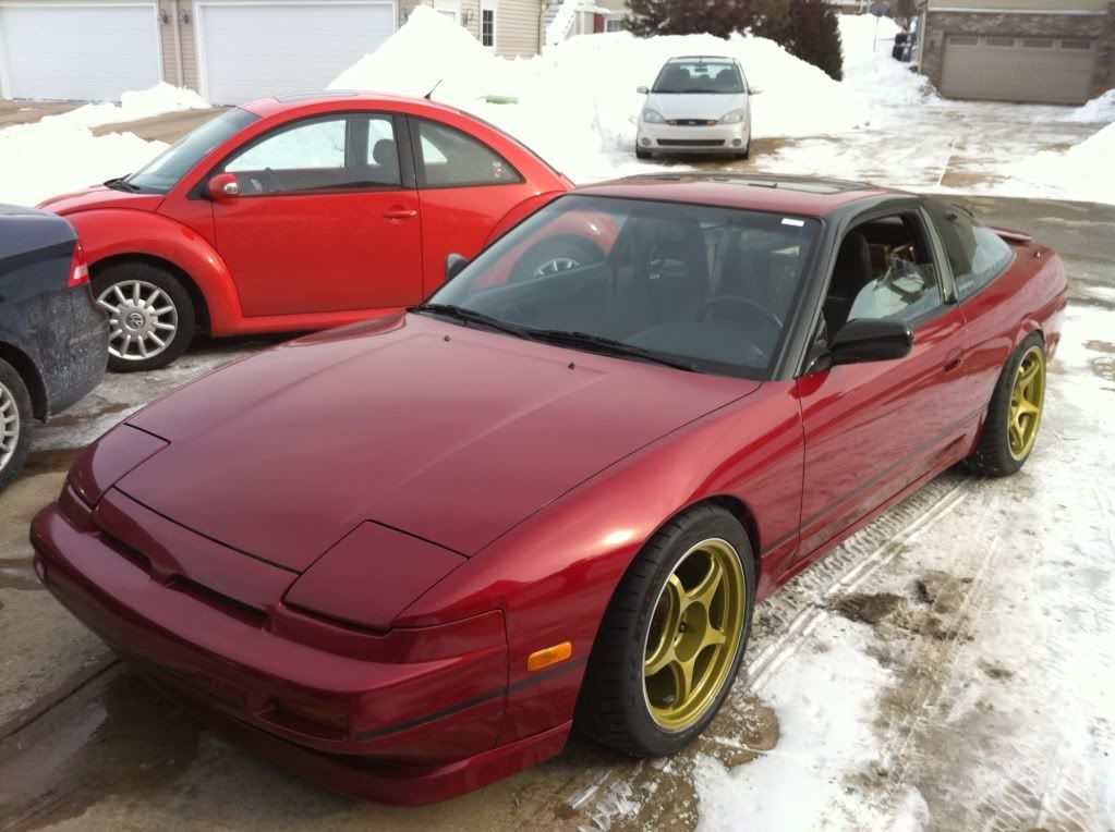

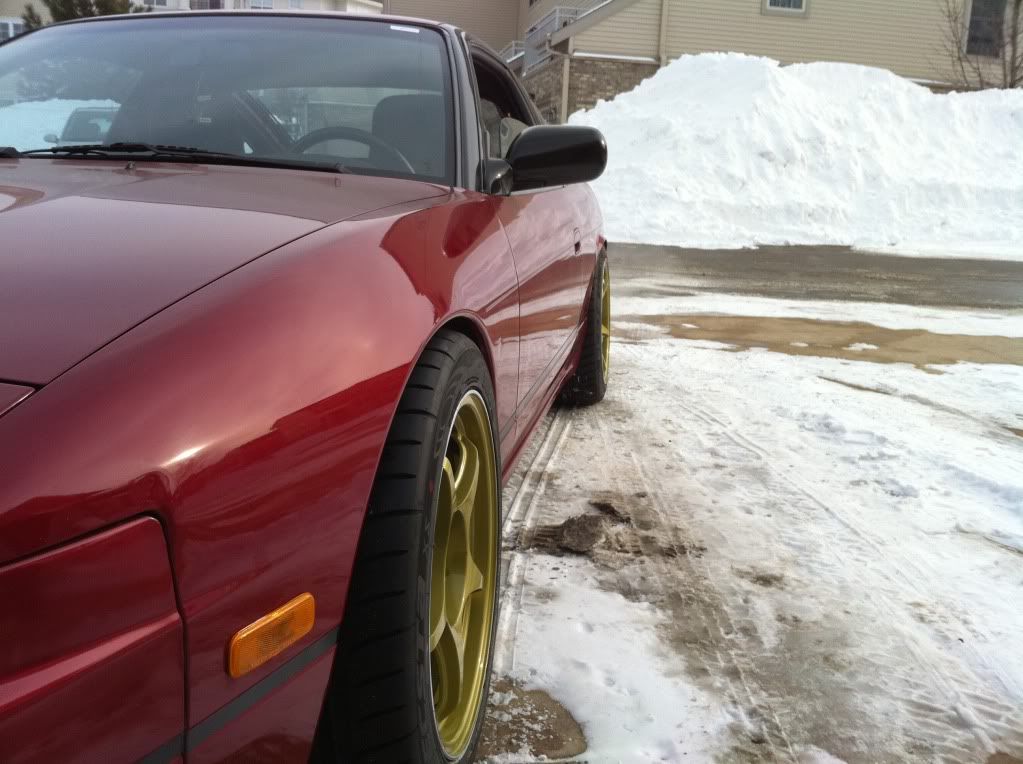

Update:

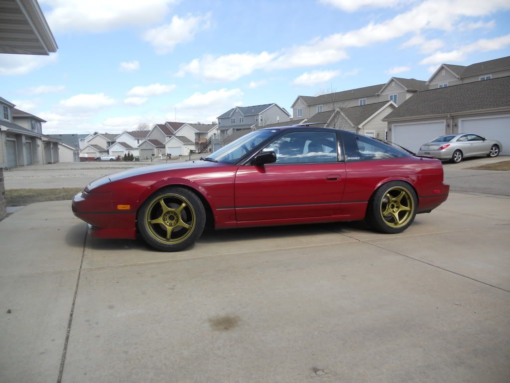

So I got my 5 lug swap done. Rear's were a bolt on affair which was awesome, the fronts caught a little snag since I could no longer use my dust shields. So I had to trim my dust shields to where they would fit, but no big deal overall.
I also mounted my new wheels/tires and rolled my fenders. Good news is that they look baller and are exactly what I had hoped they would be.
Bad news is the front wheels/tires are so wide that I will have to use fender flares/over fenders in front. The rears tuck just fine with plenty of room to spare. I tried to roll/pull my front fenders but since they are just a single sheet of metal they roll with the roller. This means it just flexes with the roller, it wont actually form the metal permanently outward. So roll forward the back bows in, roll back and the front bows in. I did this so many times that the metal on the fender itself started to buckle from being bent back/forth. Just like how you can break a paper clip or a head off of a spoon. Back and forth enough and you will fatigue the metal and it will just break.
So I ended up buying a set of ZG flares for a 70-78 Datsun 240Z. It may sound hokey, but I am only going to be using the fronts for now cause...I only need clearance in the front. I was going to do all 4 flares and cut/reweld the rear sheetmetal, but with spring here like right the f*ck now I want to drive the car. I am going to get them painted body color and they should be done this weekend so hopefully I can have the front fenders cut, new flares mounted and be done.
I also installed Hawk HP+ pads in my new 300zx calipers (4 piston) on the front. The rears do a good enough job braking so a rear swap was not necessary (not to mention complicated, I wont go into details but anyone with an S13 knows the woes of doing rear 300zx alum uprights ect). I also got SS lines (haha, for you TOM!) but the SS braids are actually covered in a clear/blue teflon sheath so moisture/road debris cannot get into the stainless steel mesh and compromise the hoses. My brake hoses are 21+ years old, rubber just gets unreliable after that kind of age (in my opinion). Also got some ATE super blue fluid to help keep the brakes in check.
I am going to try and see if the brake pedal feel is ok without swapping to a Z32 brake master cylinder. If not a new one can be had from rockauto for like $76 and it bolts right on, so not a big deal if I dont like the pedal feel.
Onto the pics.
In the pics the front is not as low as I will have them since they rubbed on my fenders. So to roll out the car I raised the fronts up so they wouldn't rub.
The calipers wont be red either, they will be black, the red doesnt match my red, so no red. :mrgreen:
I will get final pics with the flares and ride height set. Then I will align the car to my specs (have a sweet in ground drive on alignment rack to work with...drool) and be ready for spring/meets/auto-x.
Edit** I also rerolled the rear fenders to get the rear flare action to be even across the rear quarter panel. It looks more flared to the rear than the front, I have since corrected that problem.

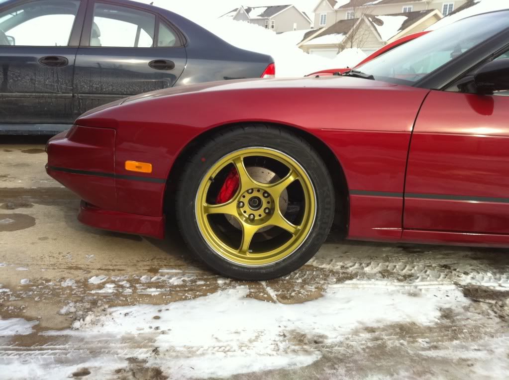

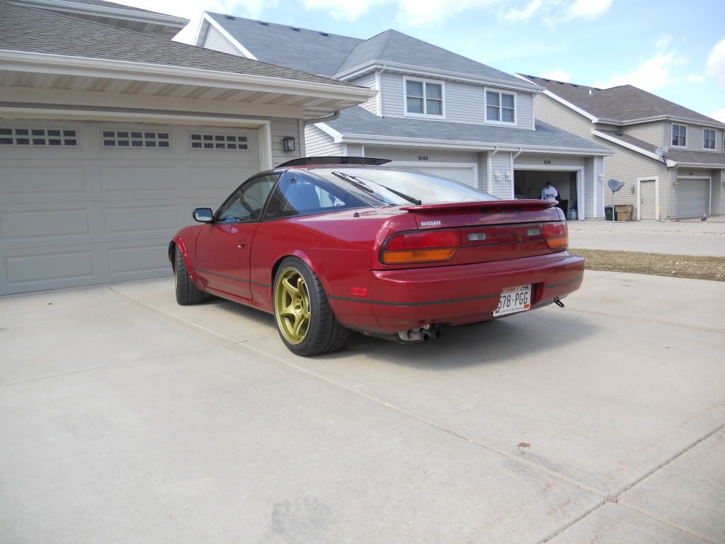

Well I got the flares back from paint and installed last week. I was out of town on business all last week so I wasnt able to clean the car up and take some real pics, but here is a quick snap of how it looks now.
I had no idea how dusty these freakin pads were either (Hawk HP+). I will prob only rock black wheels from here on out. I am already entertaining the idea of blasting/prepping the current wheels black next year (over winter).
I also plan on prob installing the flares for the rear for next year. I didnt put them on the rear because the rear tires clear just fine, the fronts were no where close, even with a roll and a pull the front fenders just collapsed from metal fatigue.
Also have to sort out why my right front brakes are braking more than my left. Roughly ~40 degree difference from left to right via infrared temp gun for both the caliper and rotor. Enough of a difference to get my attention.
Hoses and calipers should be the only reason for that. Either a plugged hose, caliper slides, pads not sliding freely, or caliper piston are my best guess.

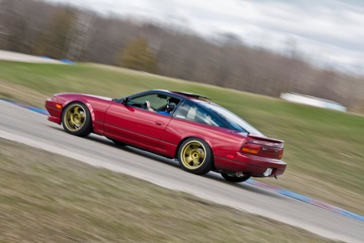

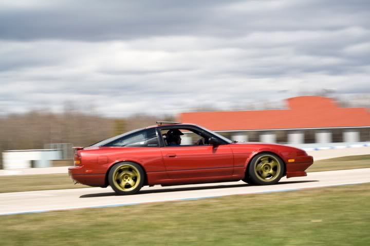

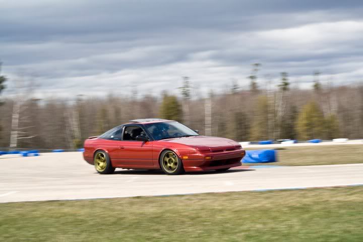

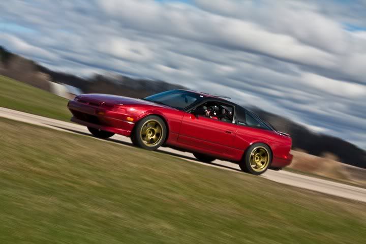

Here are some pics from this weekend at the USAIR Lapping day. Big thanks to Jake Webb and Robert Ananiadis for the sweet shots! Cannot thank you guys enough!
Gone Subie hunting. Caught em' too. Very Happy
I ended up running a 1:16.97 (I think anyways, forgot exact decimal) which is great considering I ran a 1:19ish last year. Huge improvement (all due to the tires) that was well worth it. I could pretty much never lift since I had so much grip. Track layout really favored my car's setup.
From what I understood, the street car/street tire record is a 1:16.70 by Tom Hille in his 2000 Integra Type R. I was super close to getting that time and I am sure I made several laps that were well within that time, but I didnt get timed on every lap only a specific 3 laps.
There is always next time. I ended up making about 50 laps and just didn't want to waste any more of my tires considering its still stupid early in the season.
The session wasn't without casualties either. I ended up being a bit low for the elevation changes and rubbed hard on my harness (never relocated it, done now though) when I was coming down the S corkscrew. I ended up raising my car three times in the front. What really sucks is this is about the only race track with those abrupt elevation changes so I can lower the car again for regular tracks/auto-x but USAIR is a no-go-when-ur-low.

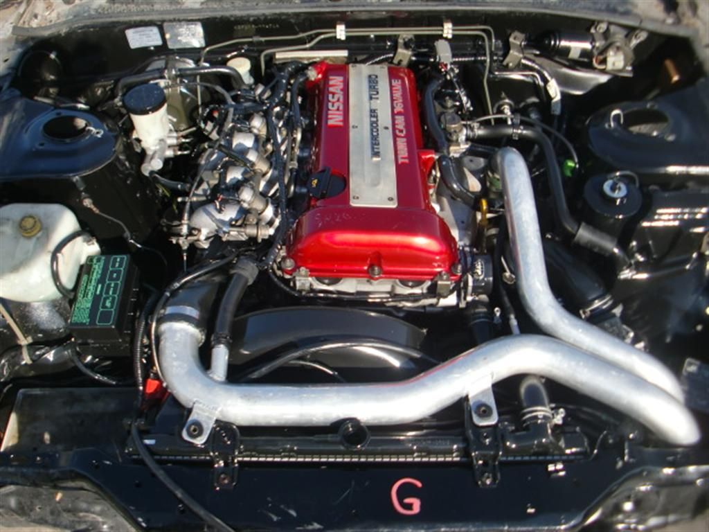

Here is my new mod/toy/ .
PostSubject: Re: Riggle's 1990 240sx.   Tue Feb 21, 2012 10:33 pm
SWEET That should be alot more fun then that ole single slammer.
