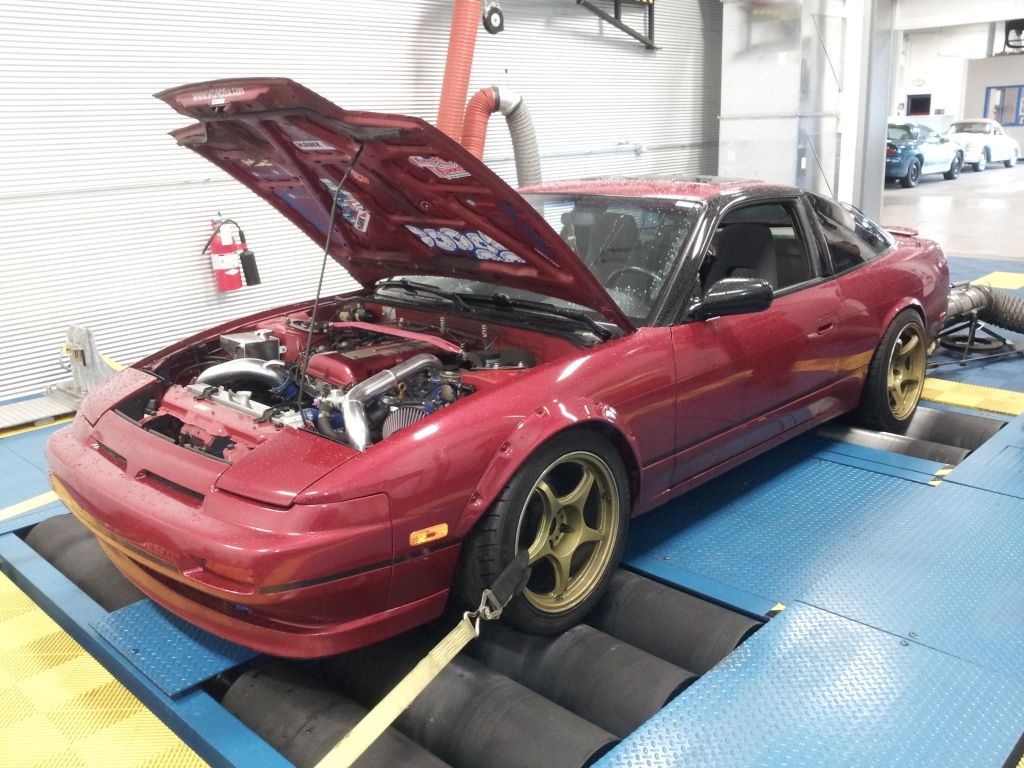

So I got it dyno'ed today....
235 WHP, 255 WTQ on a Mustang dyno. All runs were done at 15 psi. From what I read the Mustang dyno typically reads a little on the low side compared to a Dynojet, so that makes me even more stoked.
Figuring a rough 15% drivetrain loss I am making 276 HP/300 TQ at 15psi on the stock T25...not bad at all!
I was super stoked at the numbers, it was more than I was expecting to be honest. My roommate also made 217 WHP/ 250 WTQ in his 5.0 swapped E36. Beat him in both HP and TQ! Who would have thought?
Now its no longer a mystery!

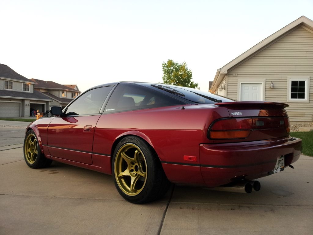

PJ's exhaust section fit awesome and quieted the car down 2 fold. It was about 2 inches longer though so it made my tips stick out a little bit more than I wanted, but I can fix that with a cut off wheel/sawzall in due time.

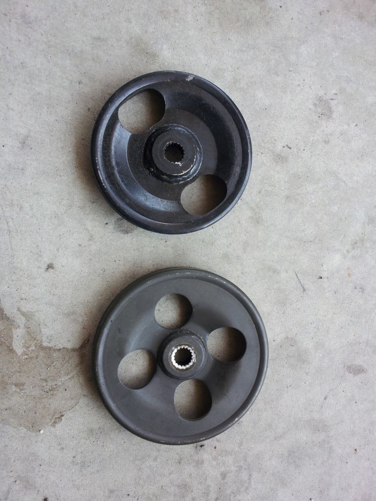

Also, BIG thanks to NismoDave for the free PS pulley, fit awesome and I cant thank him enough for his generosity!
SOHC pulley I was using vs SR, underdrive...bad pulley! Makes for terrible PS pressures.

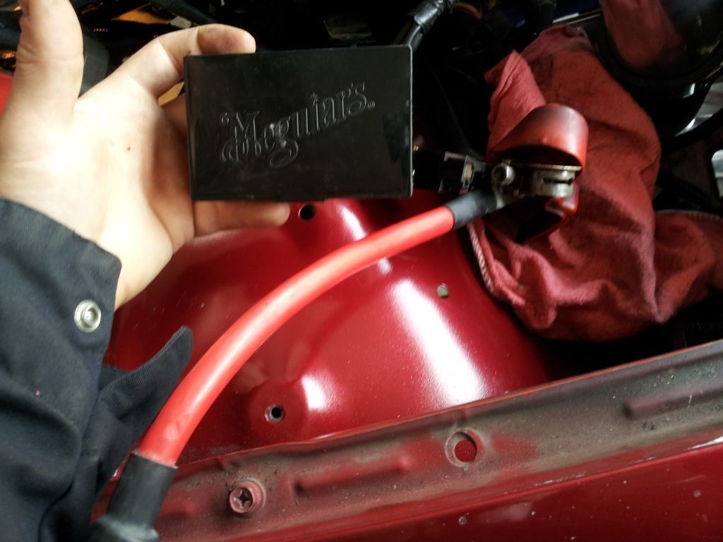

My Meguires clay bar box made a great plastic battery relocation box!

Car as she was sitting on the dyno.

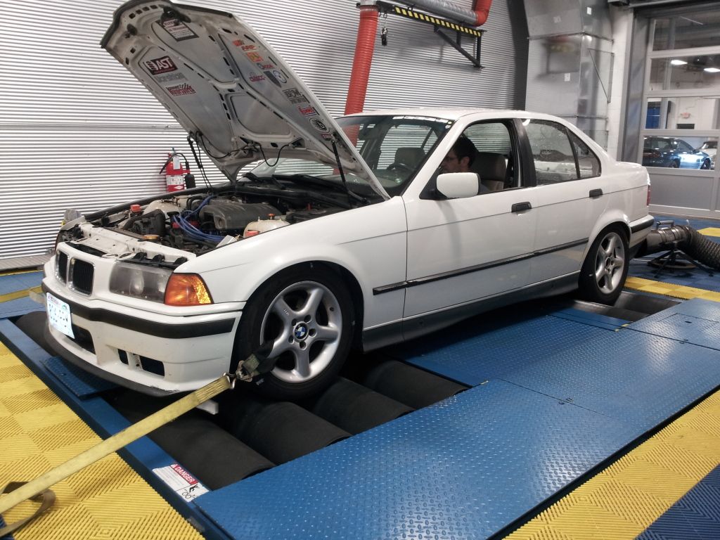

Robbies BMW on the same dyno day.
