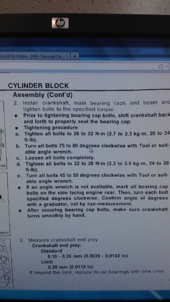

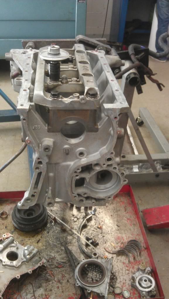

measured the crank, bearings, rod bearing clearances ill tell ya 3 angle measurements on a crank 5 mains took FOREVER!!!
didnt take pics of the crank measurements cuz it sucked but heres the torque sequence of the sr and it was pretty shitty too the extra 75 degree sucks but yeah heres the sequence and the whole block
