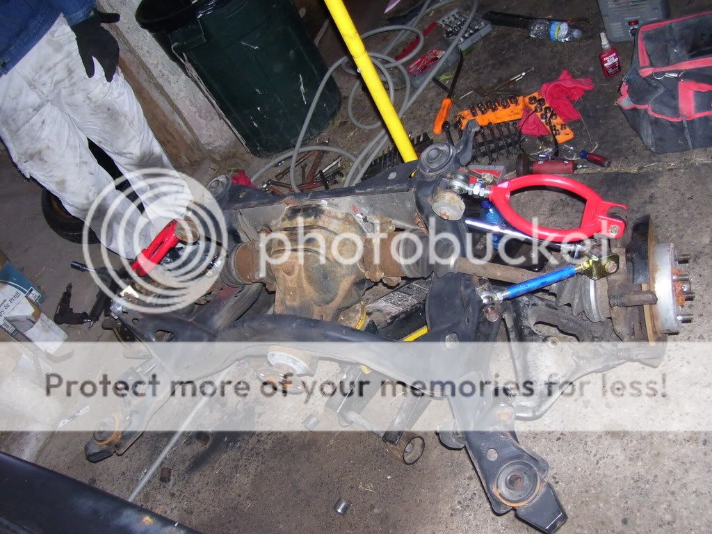

Tore out the Rear subframe. (New polyurethane bushings to go in tonight)
Along with the new coilovers and other suspension peices.

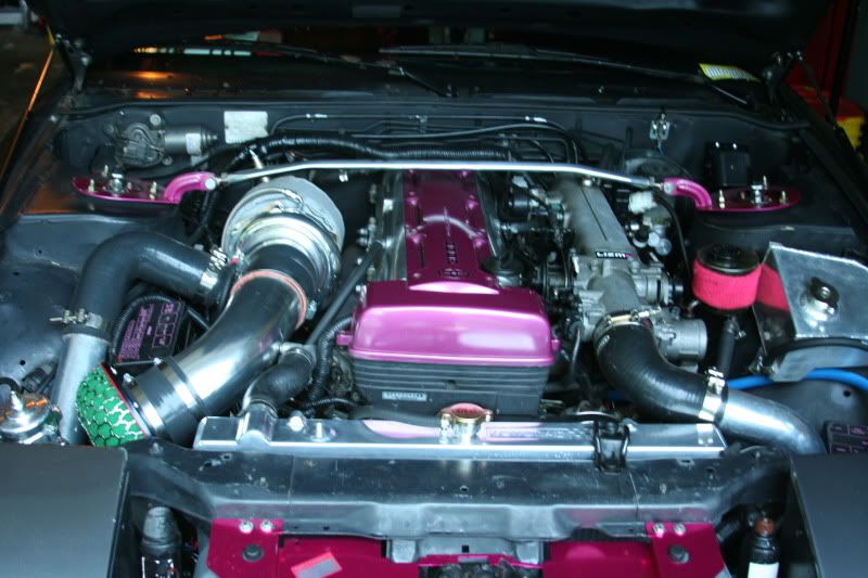

Nick finished polishing the valve covers and i plumbed up the oil feed and return lines to the turbo as well as put the manifold/turbo,wastegate and downpipe on. As well as installed a oil cooler.

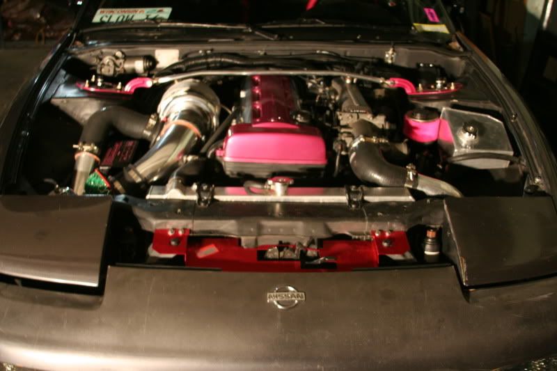

Finished doing the single turbo install as well as redoing the intercooler piping, and oil/trans cooler.

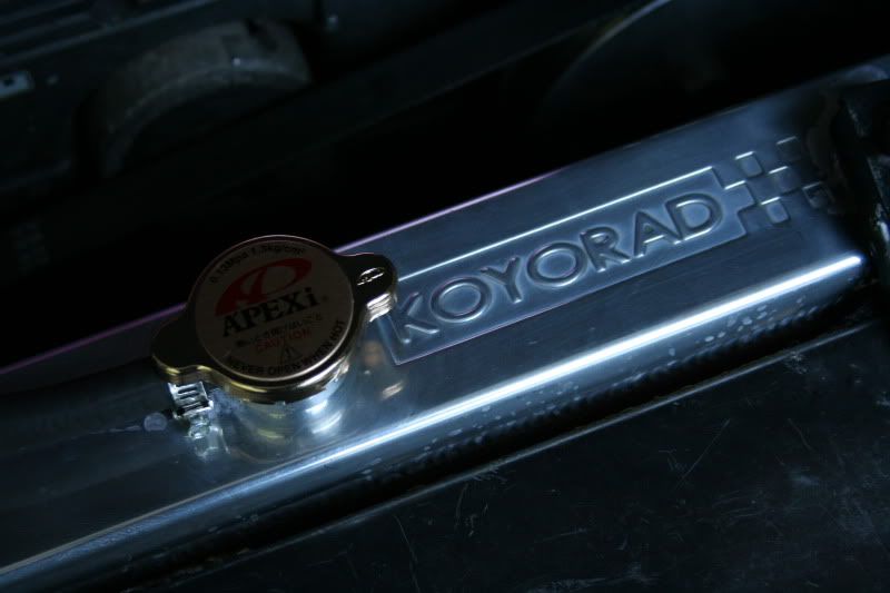

Picked up a New Koyo radiator and a apexi radiator cap. (May 2010)
