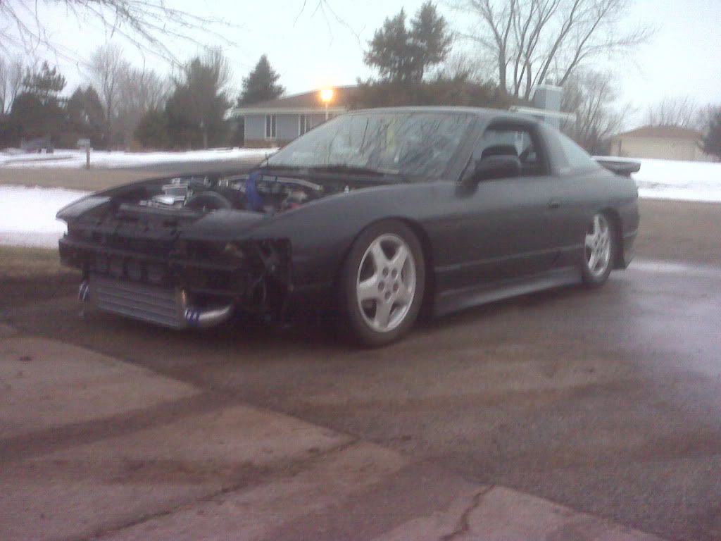

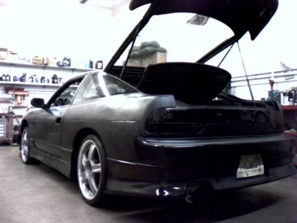

This is my ricecar(circa 2003):
Bought this gem in 2002 from a friend, well thought he was a friend. I was 14 and really wanted an s13. He had his brothers old car(original owner) and told me $250 would take it. He brought it to my dads shop and i gave him $250. He left immediately, and i mean he was there long enough to throw the straps in the bed of his truck. I couldn't figure out why he left so fast until i started the car. It had massive knock on the single cam ka (under 30k original miles). That was massive slap in the face and he to this day still hasnt answered phone. Oh well i guess. The car is From Mississippi so its rust free. I spent the first couple years stripping it down and fixing everything i hated, plus everything wrong. I dont have any pictures of it when i got it. But was a base model hatch in charcoal gray. I had to take it down to bare metal due to how bad the paint was and to fix all the dents. Not a single panel was straight on it and it was abused for some time it seemed like.

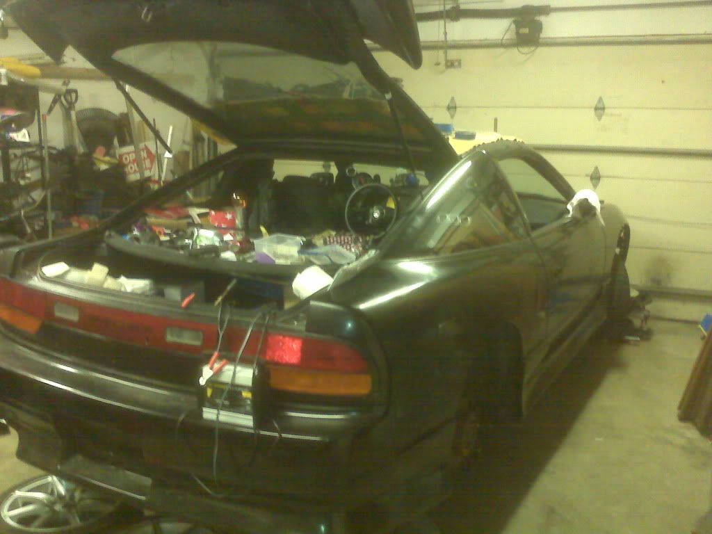

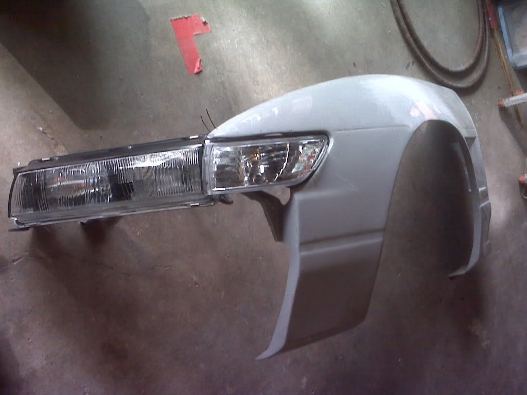

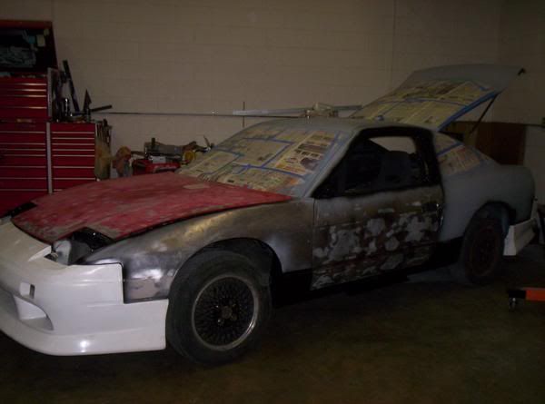

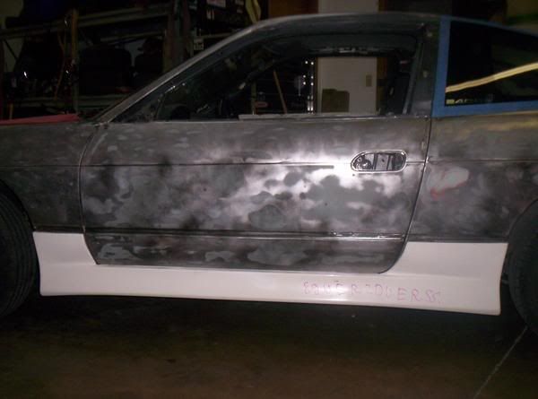

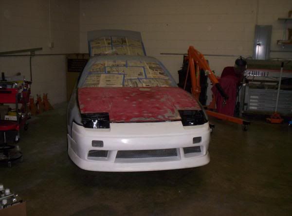

Heres some of the body work pics:

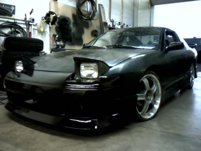

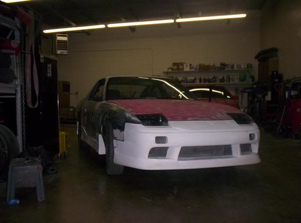

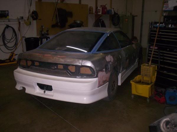

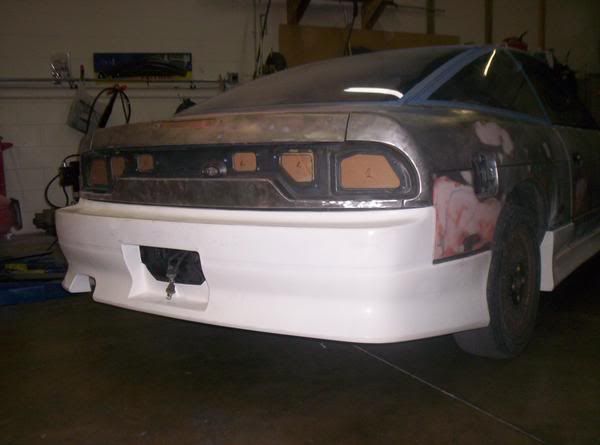

stripped all the interior minus the dash and center council to swap it out with a donor car i got from the junk yard (it never left the yard and was very clean as well). Rebuilt the single slammer and figured i make a clean daily out of it.

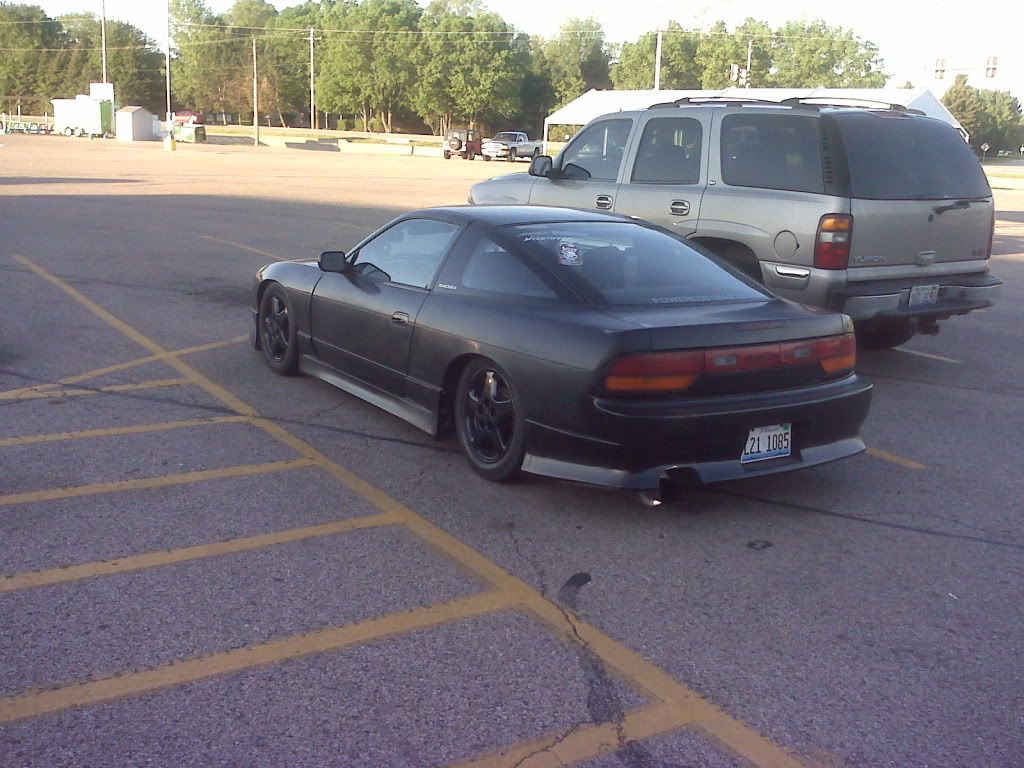

basically got it to this and it sat til 2007:

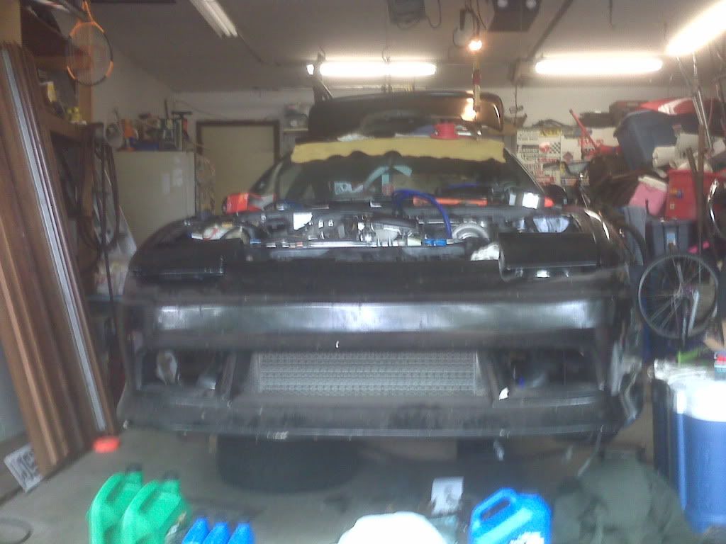

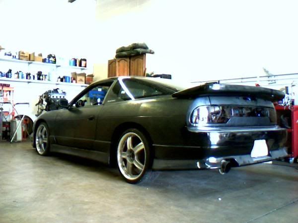

drove it back and forth to school then the maf went bad and it started snowing. Parked it to swap in a dohc ka. Fought and fought and fought with the old man until finally i said screw it and removed the car from his shop. Finished the motor swap/build and then started the turbo setup.

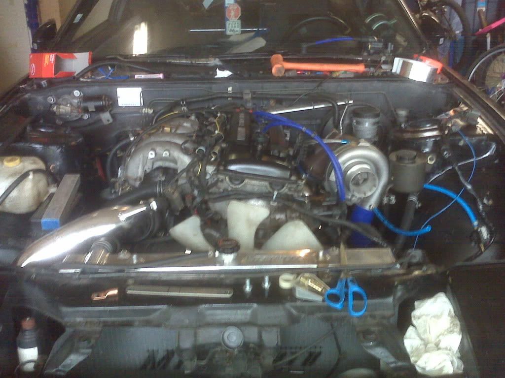

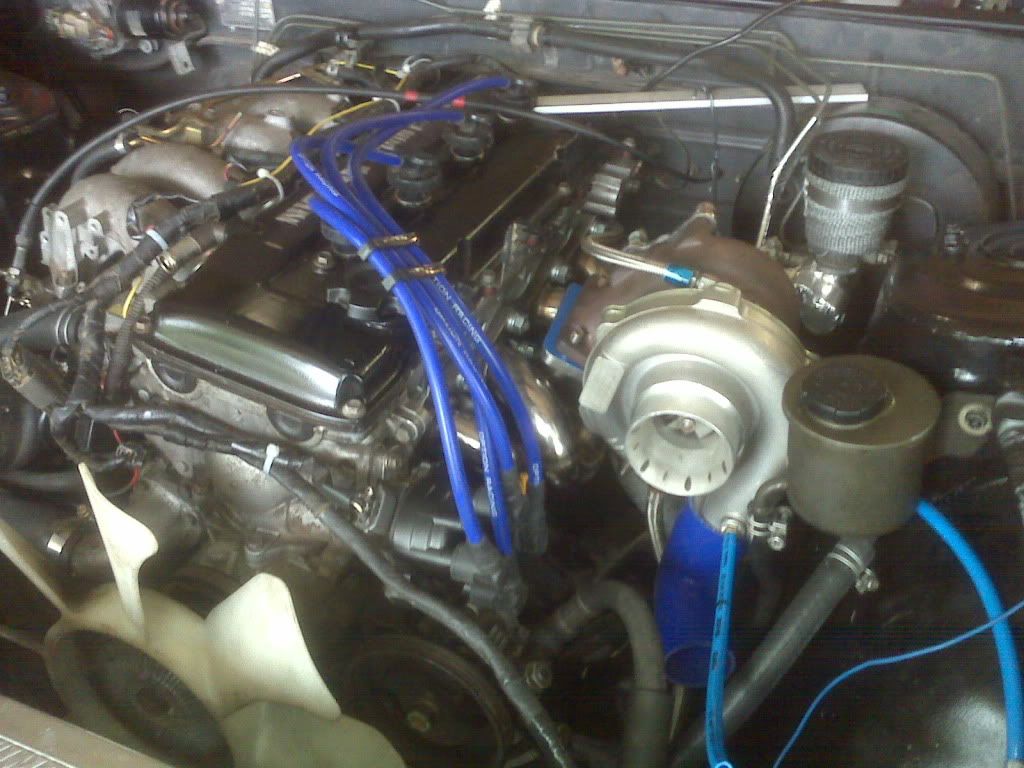

Specs:
97 ka24de block
'91 head
knife edge/polished crank
wiesco pistons 8.5:1 stock bore
Eagle Rods
stainless top mount mani (not sure of brand)
t3/t04e .63 a/r
tial 38mm waste gate (open dump)
3" turbo back exhaust (down pipe made at Merlins)
Stainless -an feed/return lines
Mishimoto radiator
PBM swirl system
Rom tuned
13psi
never been on a dyno or to a track so i dont know numbers or times. Went 5-lug while i was finishing it.

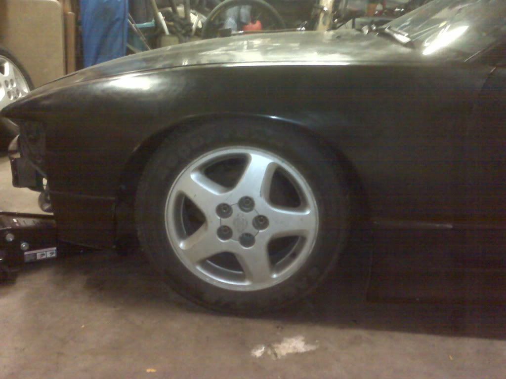

ran great, but lifted the head. SO i threw in ARP head studs. Also while i was doing that i got these in the mail:

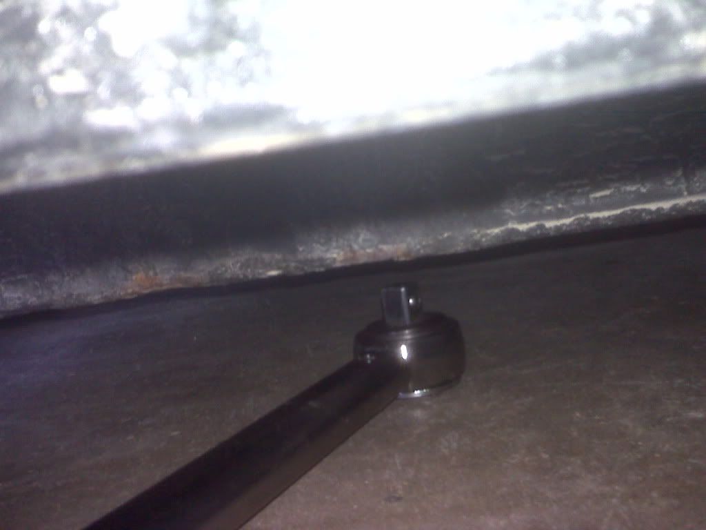

frame rail pic:

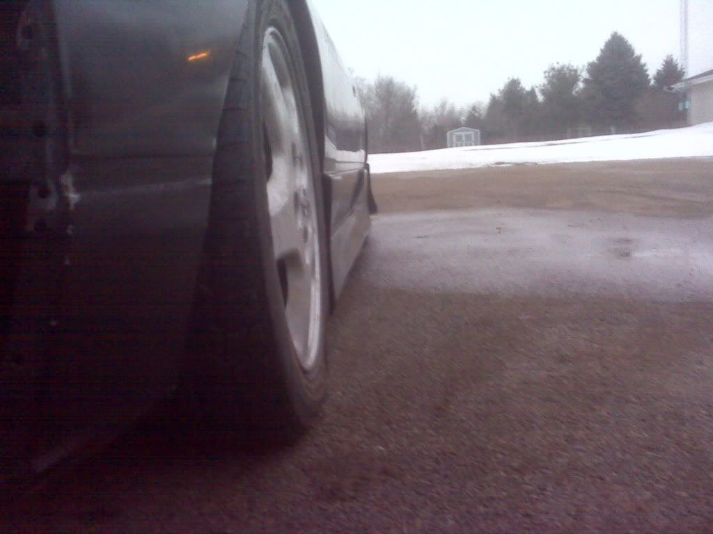

Its going to be black for now. But im in the process of having Dupont make a special color for their new line up coming out soon. So if i dont get it spayed before mid summer, itll end up being "Disco Lemonade" instead of black.
Ya i know i need spacers, but they are going to end up more or less as drift spares. I used to have a very nice set of RPF1's that got stolen out of my garage that fit absolutely perfect.

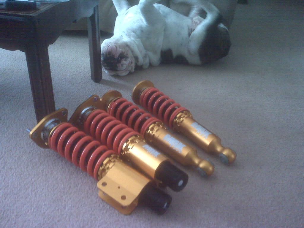

But anyways........ UPDATES TIME!!!!!!
Got home to see this little thing:

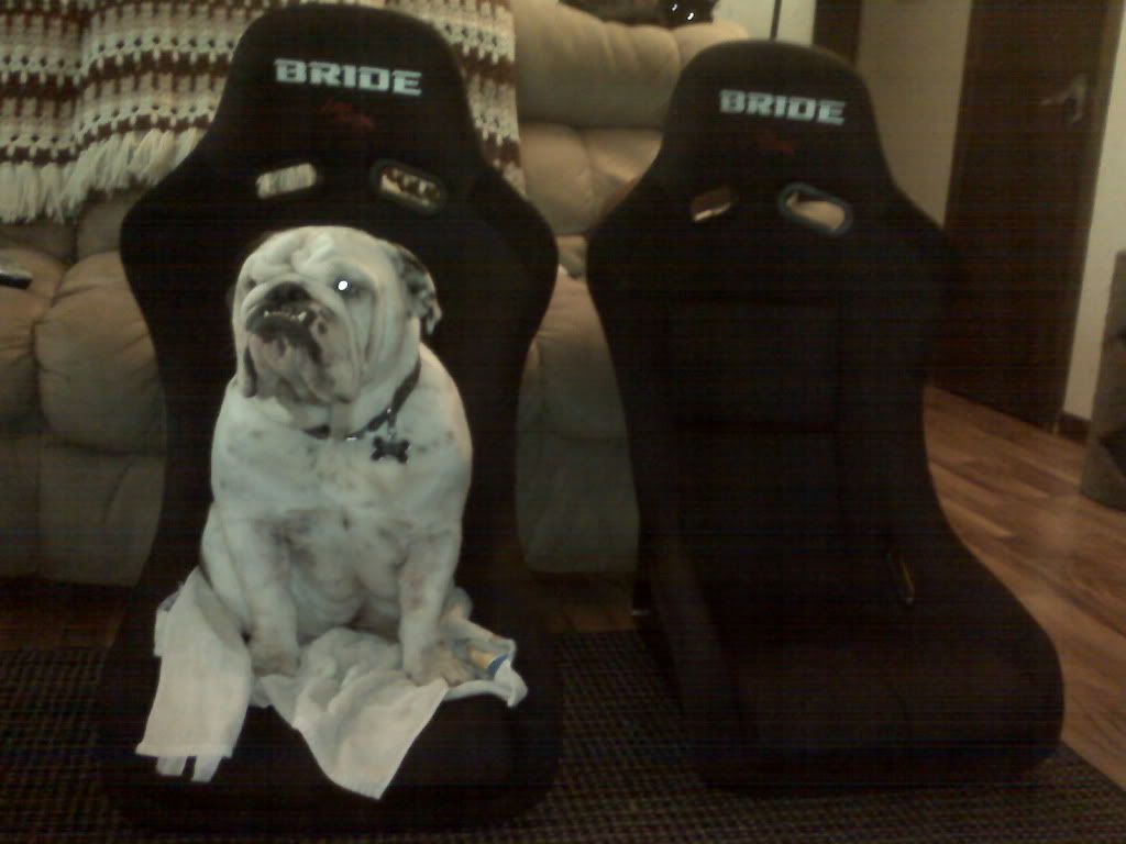

Got really excited and immediately tore into to find these:
Bride Vios III
Fat dog approved as well

Are those "real" Brides?
PostSubject: Re: Theboys Ricecar   Thu Jun 09, 2011 5:31 pm
If you want one, go get one. Hands down best dogs ever. If you want to sleep the day away they will be there cuddling. If you want to work on the car they are there with you. Super curious about everything, and just big chunky sweethearts. You cant go wrong with an english bully. I actually have 2, my 2 yer old Frankenstein and a 3 month old Emma
unfortunately i got impatient waiting for my real Bride Zeta III type L and bought the Canadian Version of the Vios. But im puzzled because they have a ton of Japanese badging, look identical minus the black back to my friends Real Vios III (fit the same way) and are FIA approved. So Im not 100% sure if they are real or fake.
