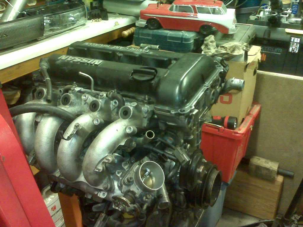

PostSubject: Re: Theboys Ricecar   Fri Jul 08, 2011 12:49 pm
ok, ive got a little update. Car has been looked over and had a bunch of crap replaced. Didnt take pics of it since its all oem more or less. Sway bar was reused, but new end links, mounts and tension rod braces were all swapped on until i get my ordered parts in. oil pan is FUBAR so the motor came out. Thought it had shavings but actually checked out perfectly fine. Since its out, its going up for sale because something better is going in.
blacktop s13 sr. Missing a bunch of stuff, but just compiling a list to get everything for it. Motor is striped to a long block rite now so i can clean it. Idk why but it seems like im a lot more picky with this one being clean than the ka. oh well
PostSubject: Re: Theboys Ricecar   Fri Jul 08, 2011 6:08 pm
oh. sr will make you keep it clean, it just looks so pretty clean haha
PostSubject: Re: Theboys Ricecar   Fri Jul 08, 2011 11:36 pm
ya, itll look way prettier than that pic when its done. But by no means will it be babied. Its put in the car to hit the track. But wont cover me in grease every time i i work on it like the ka-t i ran.
