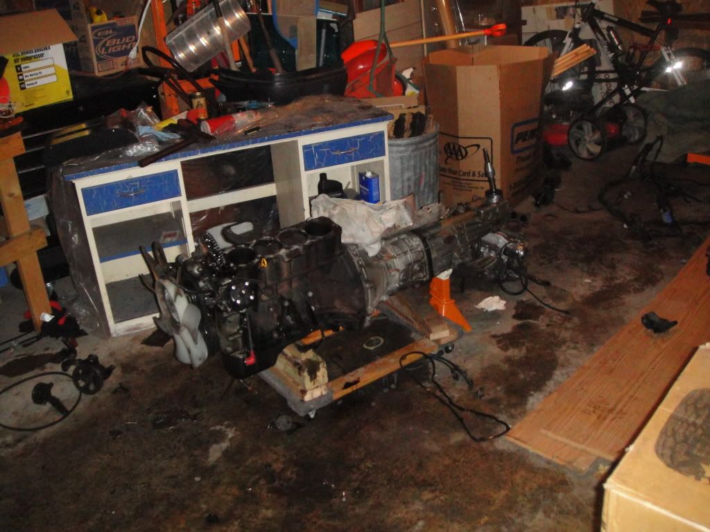

I started the partout of my old KA24E and trans. I had two guys tear the head off in about 20 minutes and they separated everything else for me as they worked. They paid me $100 for the plain head with cam, my old radiator and hoses, and my old 240 convertible's battery.
Free labor FTW. Now I just have to sell the int/exh manifolds along with everything else and I'll be on my way to a new transmission. Parting everything out will net me a lot more than selling it as a whole.
Though they left my garage looking pretty crappy.
I have a person coming to take a look at my trans on Sunday. If it sells then I will be fairly close to buying a 4l60E already.
