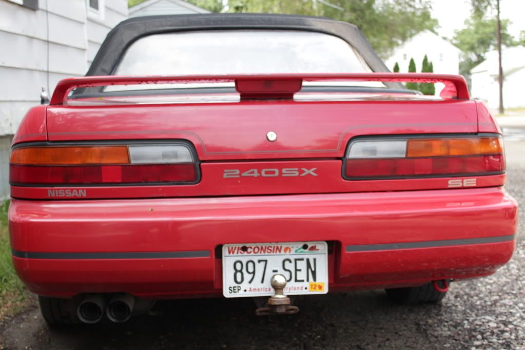

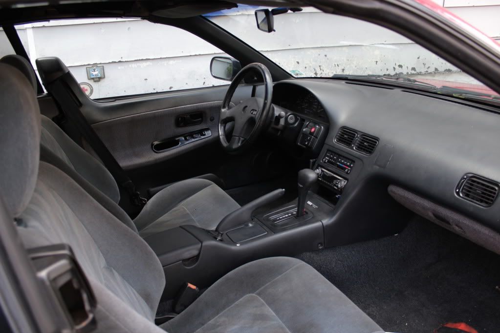

I took some more pics of the vert. I didn't get any of the poor driver's side because it started to rain. The car will probably need a new driver's side fender and I'm thinking about doing the hatch/coupe door swap to get rid of these pillars (And lose 40 pounds per door).
I am putting some serious thought into reshelling the goodies from my hatch into the much nicer vert. With some weight reduction I could do mid to high 2500's for the vert, and it would probably be a high 12/low 13 second car with a little effort.
Not bad for $600, eh?
