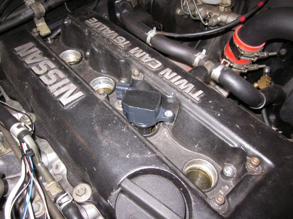

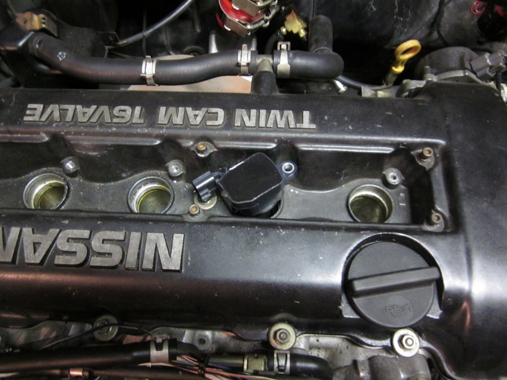

I finally got around to uploading some pics of the new VQ coils.
This is a shot of a new VQ35DE coil on my blacktop motor, as it sits on top of the plug. Mounting is easy enough, and the stock coil pack subharness fits without any problems. I am told these coils are similar internally to the S15 coils, which are a common upgrade for older SR's when making more power.
If these work well then we have ourselves a great source of high output coils you can buy new at any parts store in the U.S.

stock coil pack harness worked?
