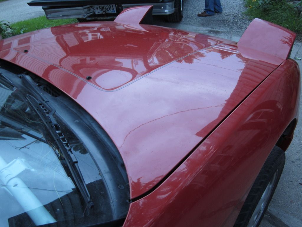

I have the new core support ready to go on, and the car's going to be needing some fresh paint soon!
What color should I go with? I'm deciding between world rally blue with a white underside and engine bay, solid black, or solid white.

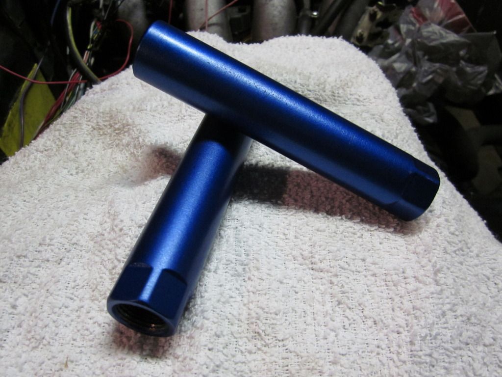

I painted my new tension rod adjusters with WRB touch up paint to see what it would come out like. Apologies for the out of focus shot, I'm using my parent's point and shoot camera.

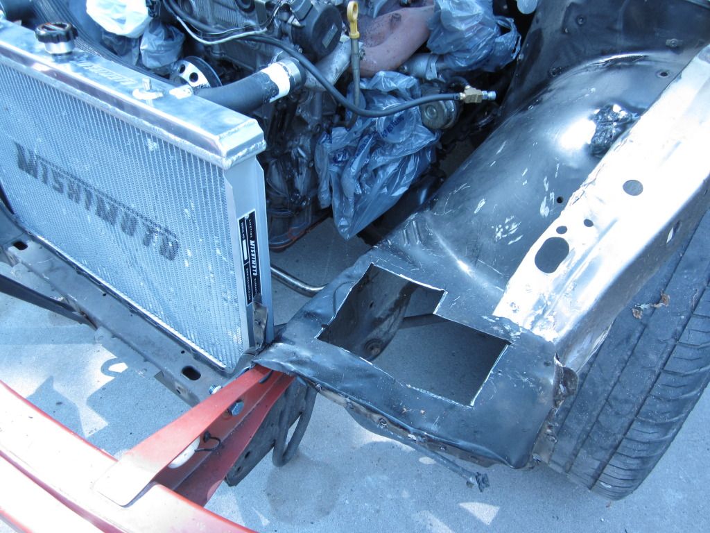

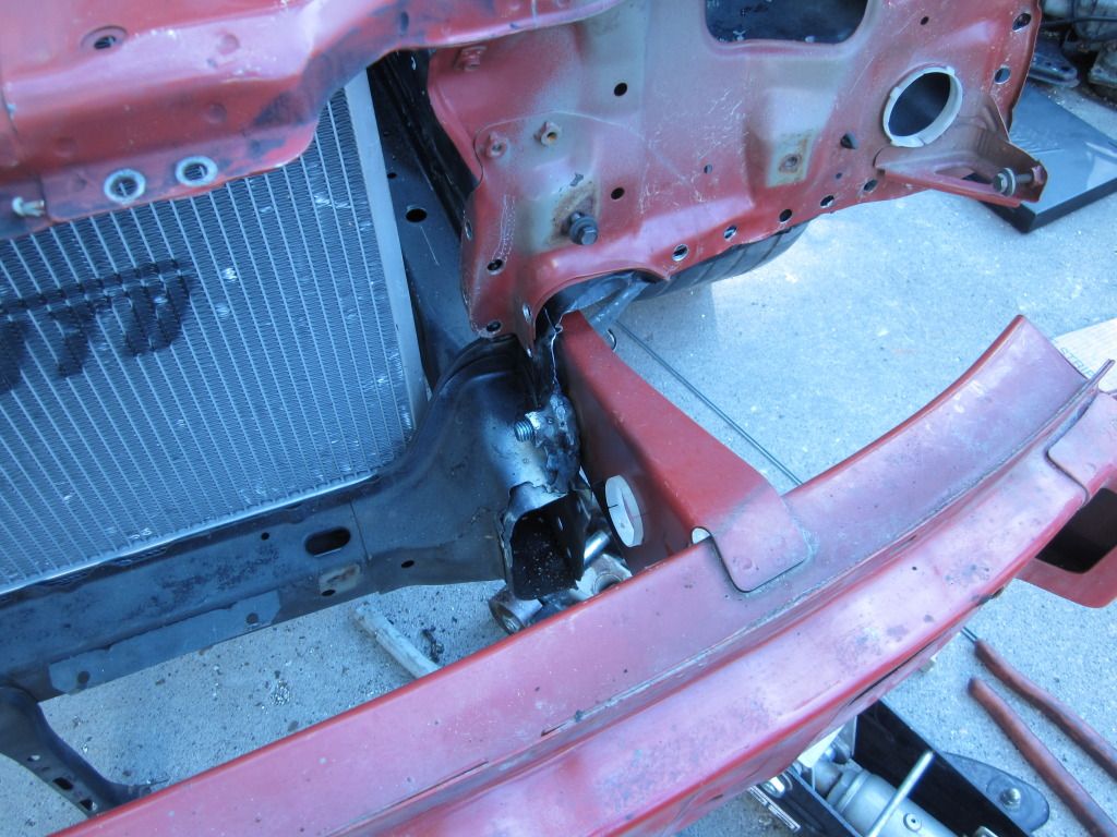

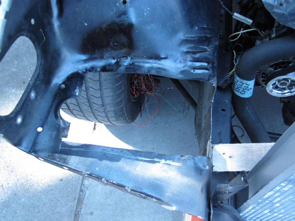

Nut and two washers welded in place, old sheet metal was shredded and half an inch further to the left here before.
A nice spot for a CF panel to be riveted in. The battery tray was too rusted to be treated so out it went. Still thinking about removing the wiper motor and mounting my slim battery there as it would fit perfectly.
Another nice flat spot for a CF panel. This side was bent from whatever the P.O. hit. Need to install the IC piping and take some measurements..

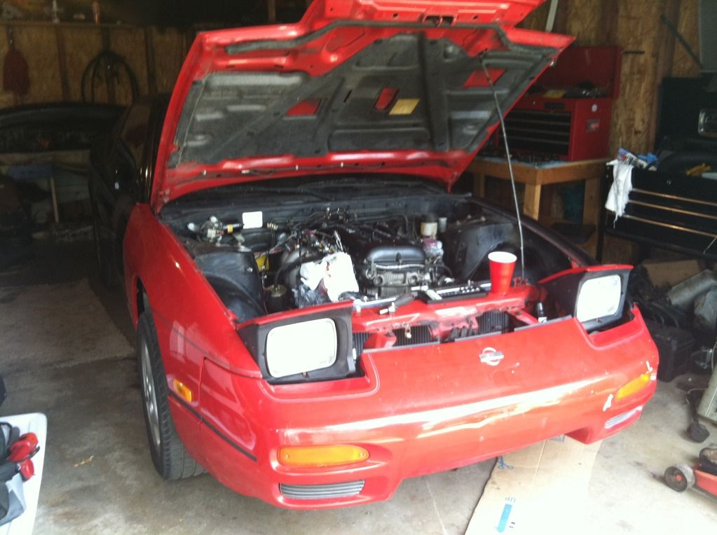

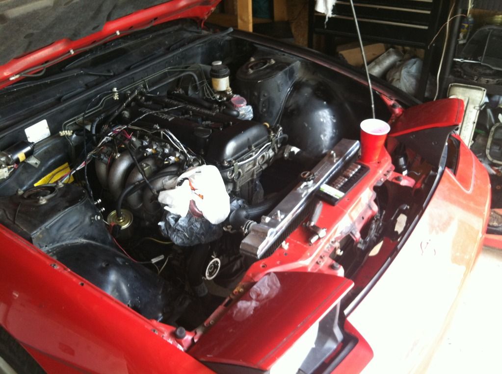

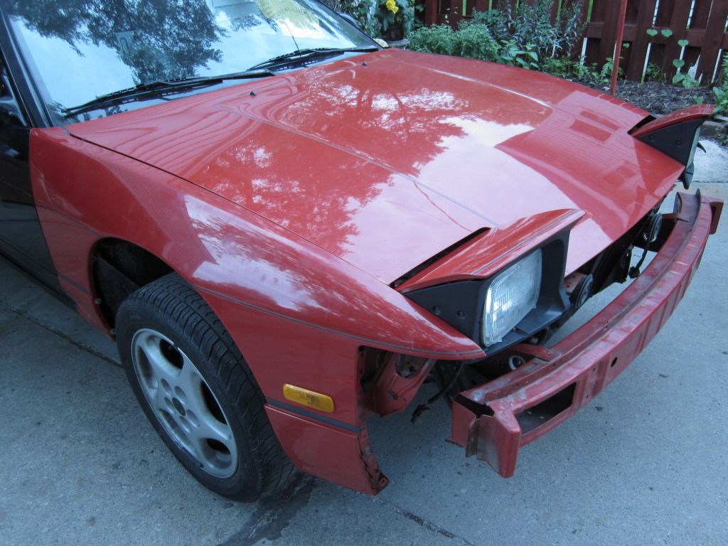

Stopped here today when it started to rain. Fenders are bolted in, core support is installed, and the hood is closing and latching like it should. It's like a whole new car. Very Happy
Also, wheel gap!!11 That's with the friggen engine and trans installed!!1
Edit: Missed a picture. The hood to fender gap is pretty good on both sides. I need a new rubber bumper piece to raise the end of the hood up a tiny bit.

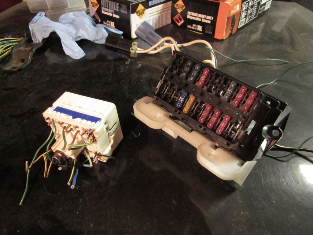

Finally getting near the end of wiring this damn thing!
I chopped this..
And hacked this off...
I ordered a Blue Sea 12 pos. fuse bank for the majority of the +12V hot stuff. I'll use an 8 pos. mini bank for the +12V switched things.
And only a few small wires will be needed through each fender so everything will be clean and easy to work with. badgerrock
