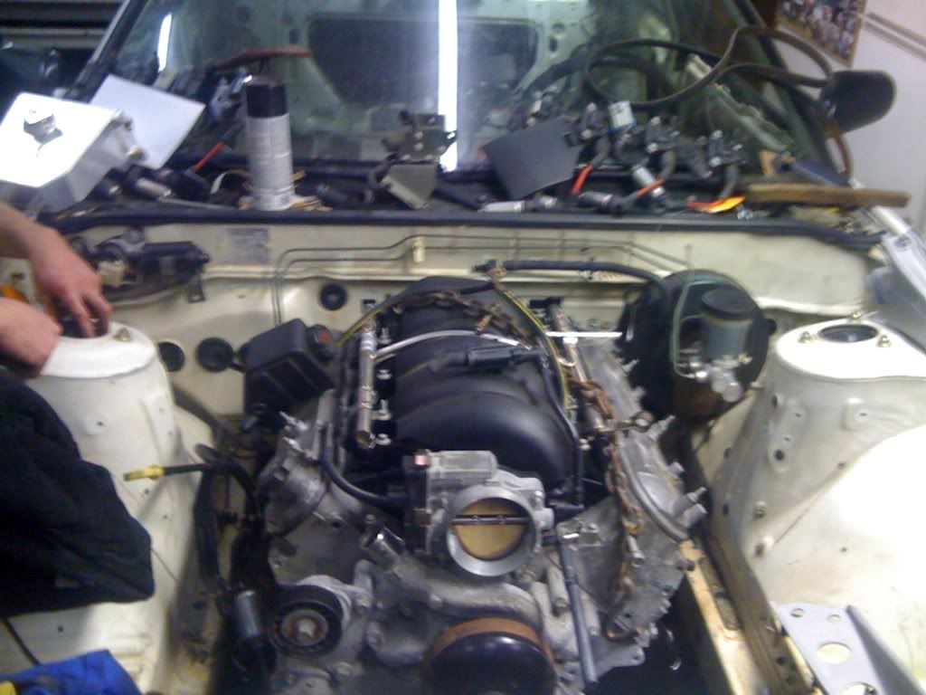

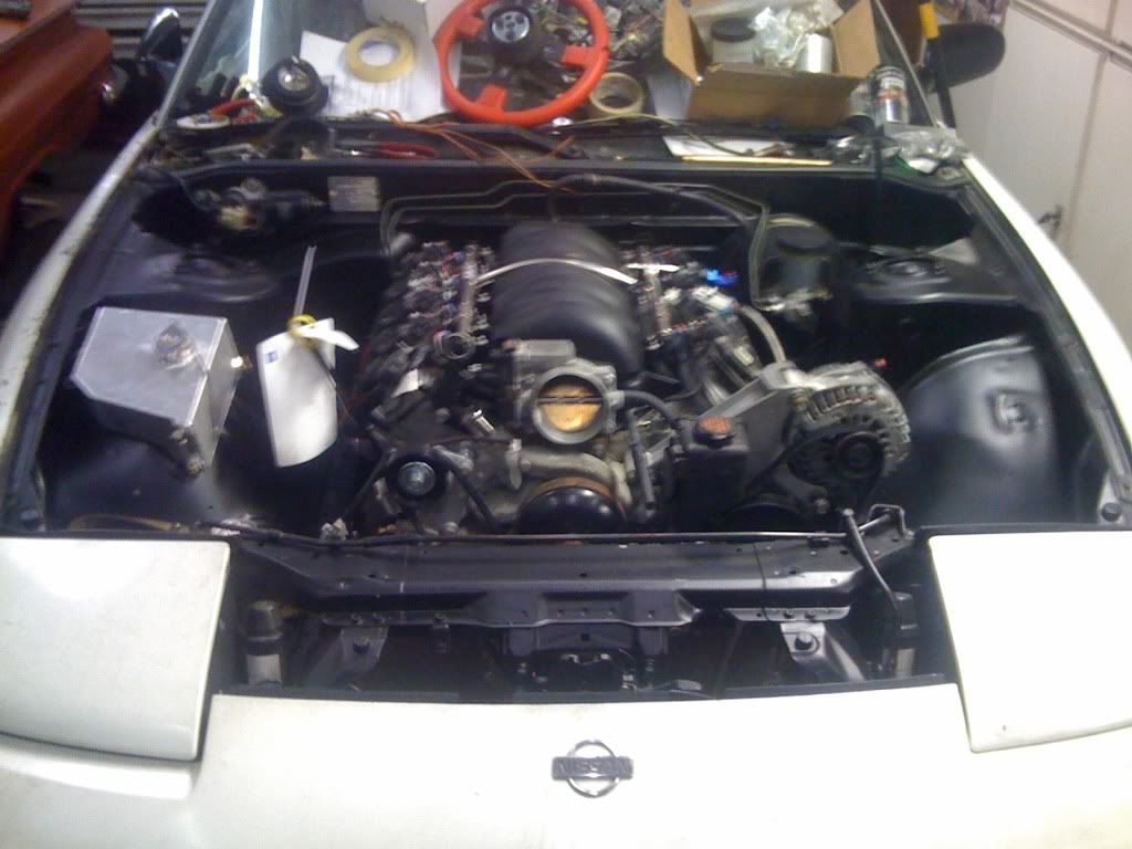

ENGINE:
All aluminum Vortec 600 from a 2007 suburban. originally came with VVT and displacement on demand but has been deleted. I have a friend that works in a salvage yard Smile he hooks it up. came from a fire damaged vehicle with 13K miles.
Livernois stage 1 cam
Livernois Motorsports Dual Valve Spring Package (Livernois Motorsports Dual Valve Springs, Titanium Retainers, Valve Spring Locators, Locks, & Valve Seals)
ARP Head Bolts
MLS Head Gaskets
Hardened Pushrods
GMPP LS7 Lifters
GMPP LS2 Lifter guide kit
GMPP LS2 Valley Cover
GMPP Valve Cover Breather Block-Off
GMPP LS7 Camshaft Sprocket
GMPP Timing Chain Dampner
GMPP PCV Hose for Non-DOD applications
GMPP MLS Header Gaskets
ARP Timing Chain Bolts
LS3 intake and fuel rails/injectors
L76 drive by wire throttle body
08 GTO oil pan and gasket
1 3/4 primary 4 to 1 longtube headers with 3" collectors
Tuned by ed at http://www.doneriteautomotive.com/
need a real tune? go to him hes the man^

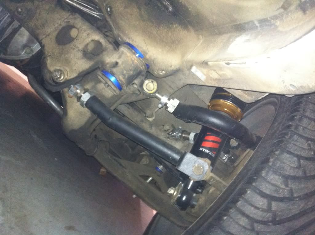

SUSPENSION:
SPL front Tension rods and custom tension rod bracket reinforcement
SPL rear Toe rods
SPL rear upper arms
SPL rear tractions rods
SPL subframe collars

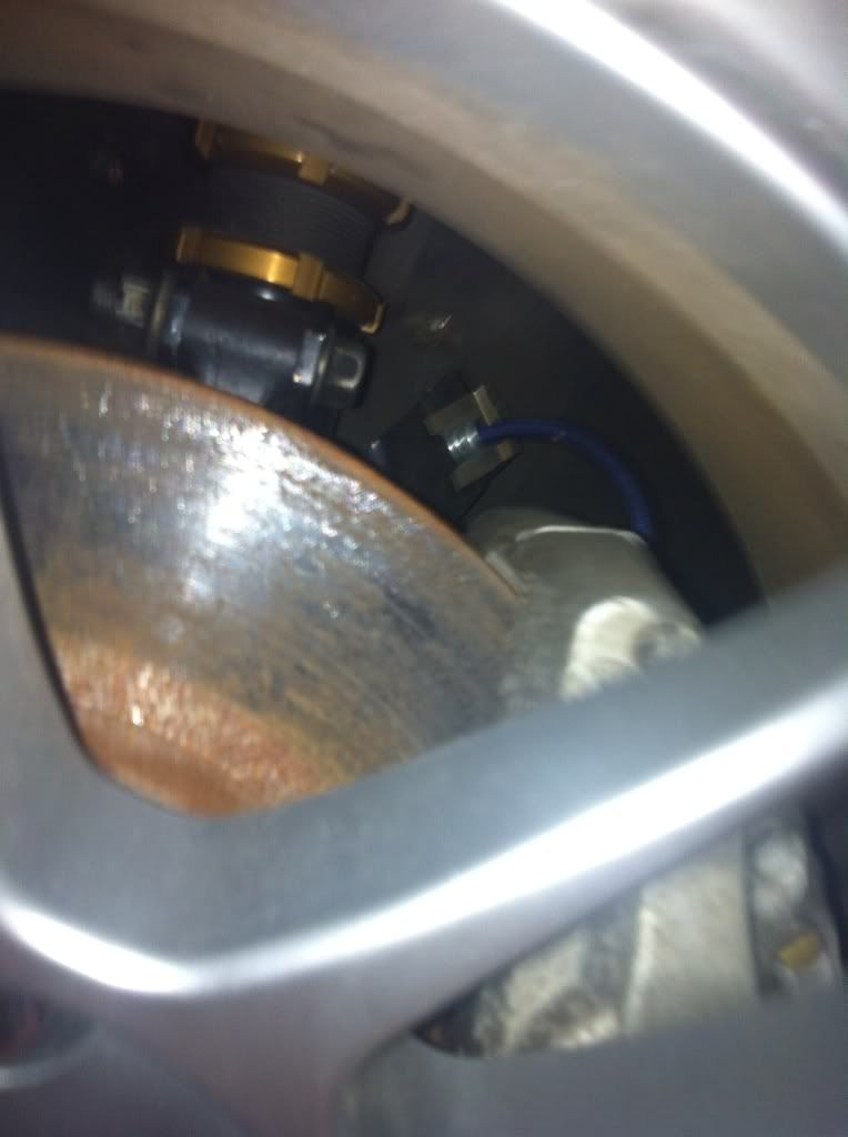

300zx TT brakes all around
300zx TT brake master + booster
300zx E brake assembly
Steel braided brake lines
DOT 5 high performance brake fluid
bumper to bumper pads and rotors
new 5 lug conversion
new wheel bearings

Stance GR+pro coilovers

Any dyno numbers or track time? What accessory drive is that.
PostSubject: Re: My 6 liter goodz    Tue Mar 06, 2012 6:38 pm
Truck.

yeah dual 3" just doesn't work though it did make good power. Its a suburban alt bracket. stock heads! and 9.5 compression tuned on 93

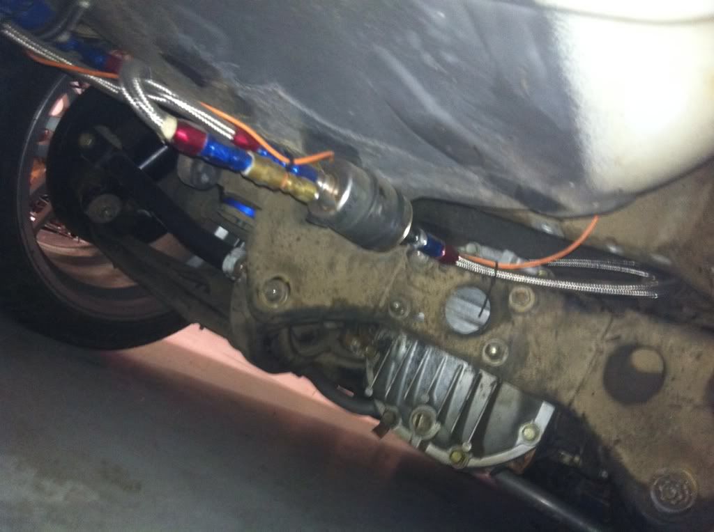

new exhaust. 4" to Magnaflow 4" racing muffler and fits great
I will have to relocate the fuel lines. got a chance to race an r35 and completely botched between finding gears and getting traction.. T56's blow
