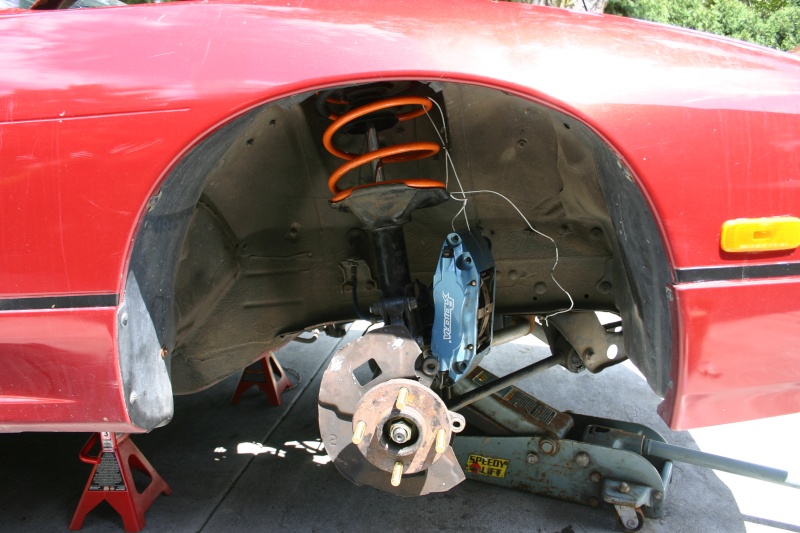

About a month ago I noticed that somehow a few of the wheel studs on my front wheels were very loose and could be pushed in and spun with my hand. It turns out that the previous owner had put in extended studs in the front to accommodate the aftermarket wheels, except that he got studs with a knurl diameter that was way too small and that had caused the hub holes to actually round out.
So after searching around on the internet I found a set of 60mm extended wheel studs made my ARP that fit s13 4-lug hubs front and rear, which happen to be a GM Part number. For some reason the previous owner did not replace the rear studs, so I decided if I'm doing the fronts, might as well do the rears too.
Next, I looked for a set of front hubs because I could not use my rounded out ones in the front. I luckily found a set of 2 fronts and 2 rears for only $25.
I was also tired of riding around pick-up truck style, but I didn't have too much change in my piggy bank. I decided to order a set of Megan Racing lowering springs and they seem to be very good so far. They have lowered the car significantly and the ride the car seems more planted, although it is a lot more rough when it comes to bumps.
Fairly easy install...
This is with only the fronts installed
I'm gonna try to get a few shots of the car lowered on all fours so you can get an idea of the difference. I also buffed the car and will be posting some before and after pictures. Again, thanks for lookin.
