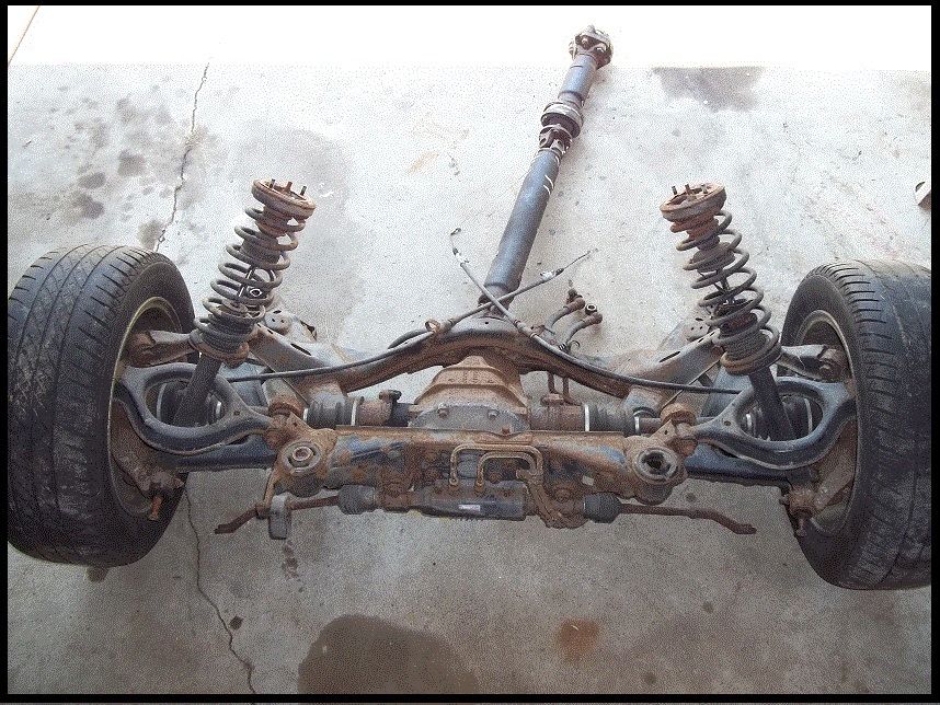

This was a HUGE pain, but at least there is some progress.....after about 6hrs of work
Familiar view
Bling Bling!
Supervisor

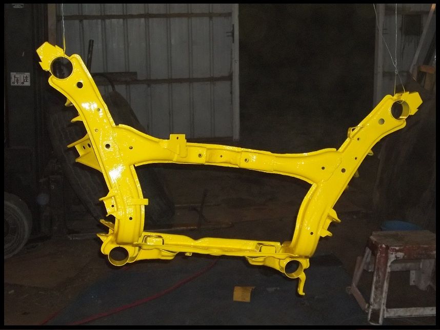

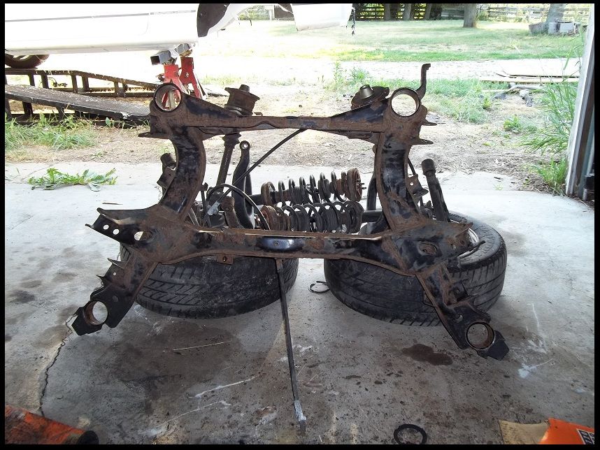

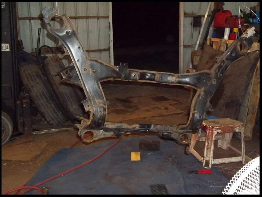

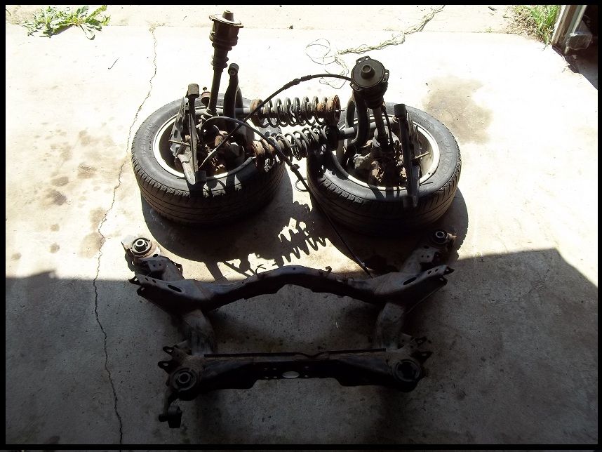

Dragged subframe into garage
Everything apart
Bushing cut out
Getting ready for paint
All painted up, time to order some subframe risers!
